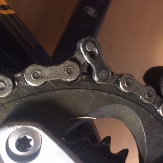

Right - this really works for me: pop the quick link forward a tooth on the chainring, then give the end of the link a whack with a rubber mallet / handy but of wood. Should pop right open.

Give the power link a slight file with a rat tail file before you fit it.. much easier to remove by hand

As a 951/1051 user, I use the SRAM power links all the time. The trick is to take the links either side of the power link and pull them together so your power link is at the top of an inverted triangle. Then take your needlenose pliers, place against the outside roller area of the power link and squeeze. If I can find the video that showed me the trick, I'll post it back here.
