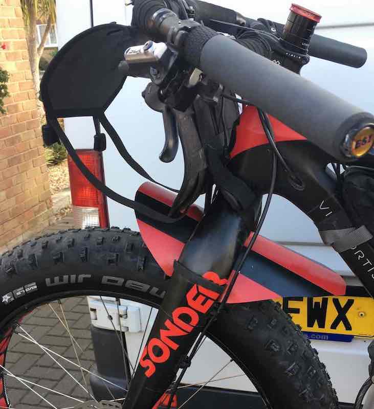

I had a min bike fit to bring the fat bike in line with the road and mtb bikes. They dropped the jones bars a bit and adjusted the seat position bringing it fractionally forward. They were very keen that we keep adjusting positions, but I find it very comfortable both at Coed y Brennin the day before and the BB200. This is the current position and angle.
- IMG_2948.jpg (46.94 KiB) Viewed 7500 times
