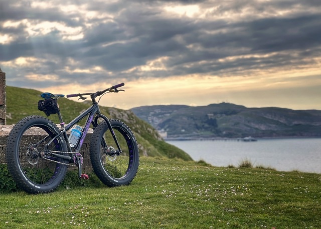

My OnOne fatty is running the stock Sram drive train (2×9 I think) but it is a bit long in the tooth now.
I'm thinking of going for a 1x11 conversion, but not sure what id need.
Anyone know of groupsets available that could be used for this?
Thanks
