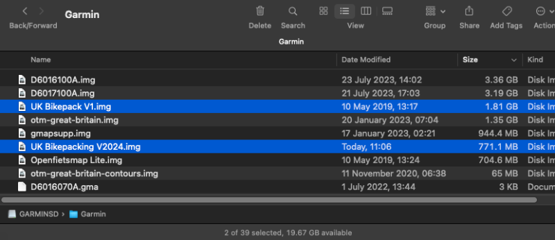

I'm also having issues Dave, it's not recognised by Garmin, it's also a lot smaller than the v1 version. Will try re-downloading etc and setup again incase.
Screenshot 2024-02-18 at 11.54.59.png (88.63 KiB) Viewed 2168 times
Posts: 3830
Re: Dave's Bikepack Maps
It should be smaller. I’ve only tested in Basecamp

BC isn't seeing it on a SD card, whats the best way to convert it to a gmap for bc ? The old software I used to used doent run on modern macs anymore.

Yep, dumped it on to the edge 1000's sd and it's seen straight away in basecamp.
Looks totally different colours wise to the v1, is it based on a different base map?

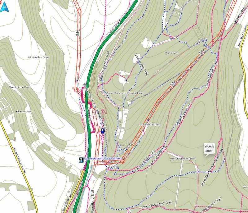

Please in no way think me ungrateful for the amazing work you have done on it, but is there any. way to have the new data with the old look?
I enclose one one of my local haunts QE Park in both the V1 and V2024 maps from basecamp, same detail level and zoom. Yes there is more data in the 2024, but I find it so much more difficult to read than the V1 version.
The reason I origianlly asked about updates is that IMHO the v1 is the best map set I have every had, so much easier to read on Basecamp, an edge, heck even on a Fenix it's good.
Here is the V1 Screenshot,
V2024 is the next post.
