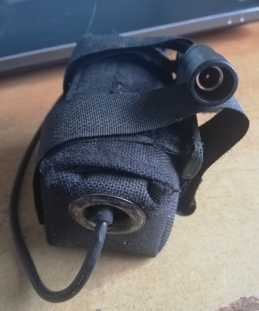

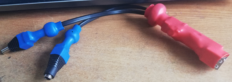

After a bit of searching I found a small DC-DC convertor with a dual USB outlet that looks like it'll do the job, load testing so far has not shown any real problems charging Wahoo Bolt but it's significantly warmer charging a smartphone but nothing alarming.

My Battery

My Battery

Finished article
- finished article.PNG (377.54 KiB) Viewed 1368 times
