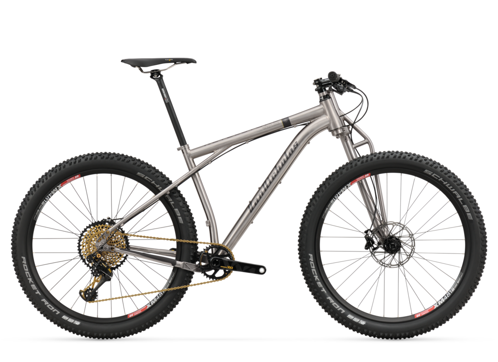

Ooh I do like that Colin.
Someone I know rides this :wink:
Re: Jones truss fork on another bike ?
Two nice machines there, not seen that Van Nic thing before. Hmmm maybe I do want a Ti frame......
Not convinced about the saddle on the moto though :grin:
Neither is he anymore Phil - takes a cushion out with him now :wink:
Post by pistonbroke »
That Ti fork on the Van Nic Revelstoke is €1300, or the same as a Lauf with change for 100 blindfolds
AlasdairMc
Posts: 1270
Post by AlasdairMc »
Having cracked a truss fork at a weld, removing half of the legs doesn’t fill me with much confidence.
