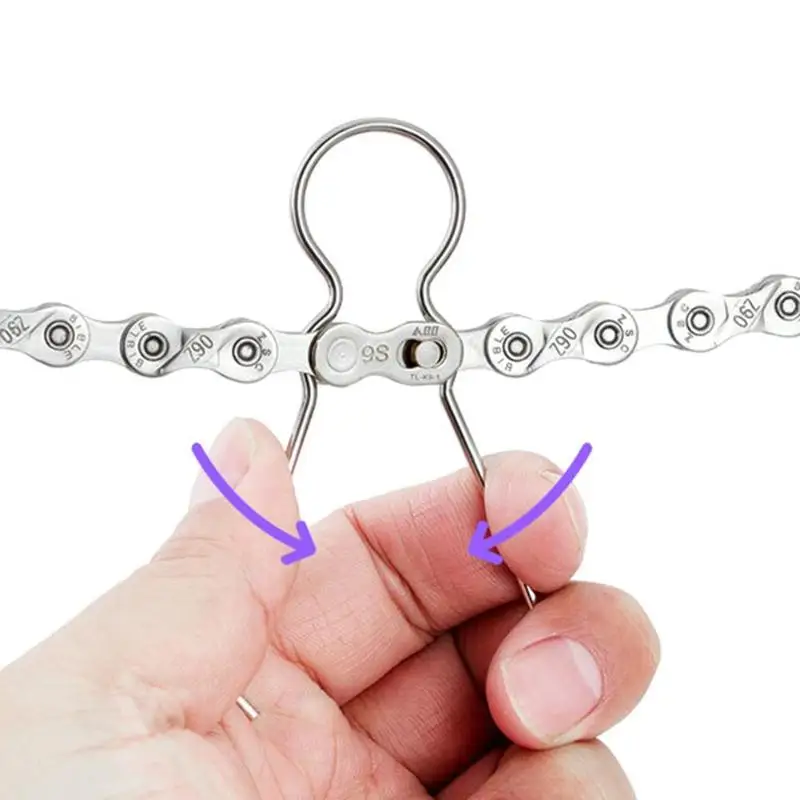

Great timing! My chain snapped on Monday (less than 300 miles old) just before the quick link. No way I could open the quick link by the roadside (Stu must have fingers of steel!). I have been looking for a tool to carry with me so that ones just been ordered
Re: Chain pliers, needed?
Think ease of opening a quick link depends a lot on what speeds the chain is. 9 speed, easy by hand. 11 speed significantly more difficult.
this is cheap and light weight but robust. Ive used them on the trail without issue. Hidey place for a split link too
[url]https://www.aliexpress.com/item/4000295 ... 23420/[url]

I have a pair of plastic ones like those on the first Aliexpress link above but found they weren't strong enough for my 11 speed links. Not all plastics are the same so those might be better.
The Granite Talon ones are far better and the same weight as my 'old' Pedros plastic tyre levers.
agreed 11 speed are considerably tighter than 9 speed ones
taking them of a clean chain is considerably easier than when its full of grime
Plastic might work but I dont think I would want to rely on it
The woolftooth [gift] is phenomenal and light but I dont think i would spend that on it
googling the talon above i got this " copy" of the woolftooth for £13
https://www.amazon.co.uk/Gyratedream-Mu ... 0G2HQQ55V0
I strongly do not recomend shopping at the amoral tax avoiding bastards that i consider Amazon to me- other ethical views are available- but it only seems to be available there from my short search.
