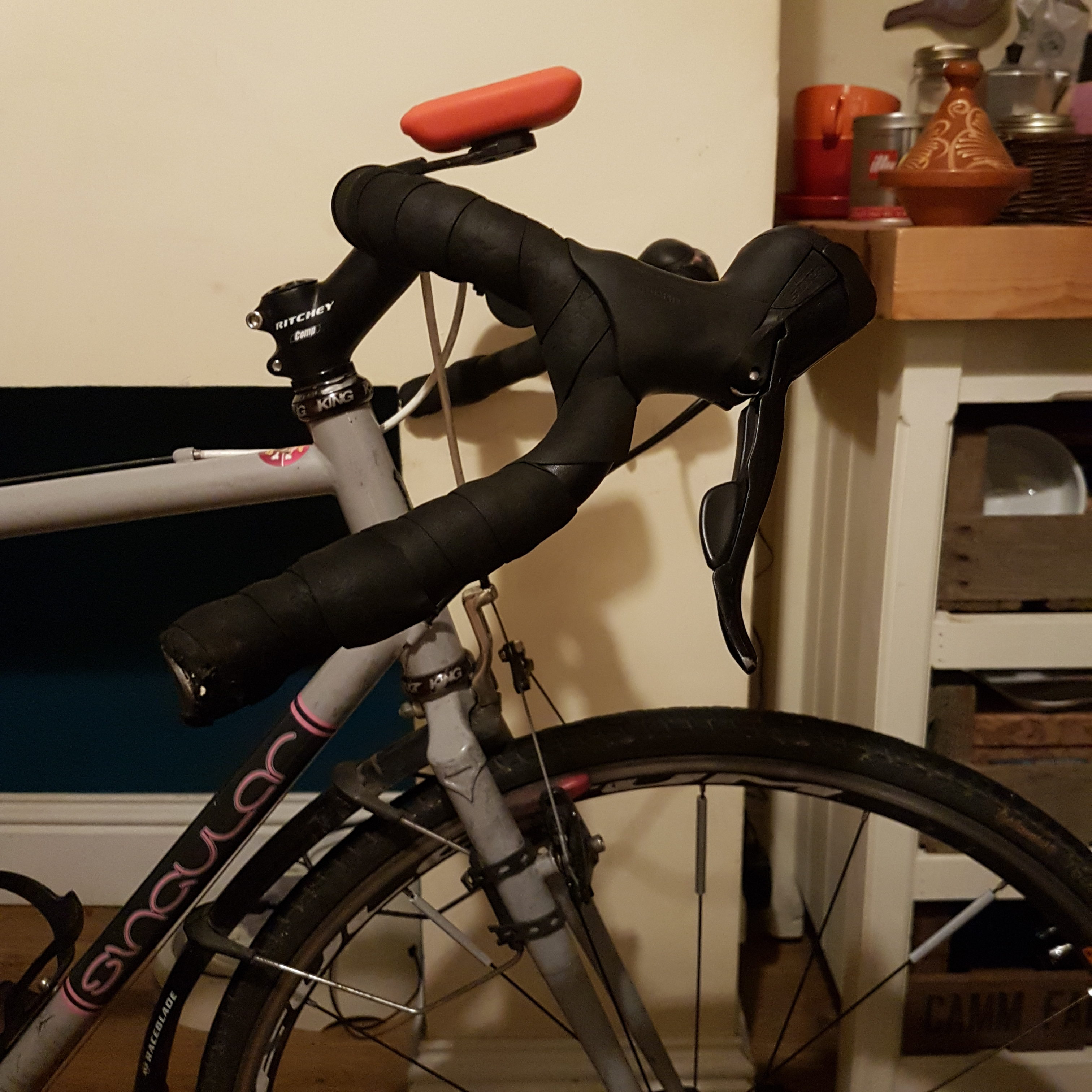

Agreed. On my Fargo I ran the woodchippers with the drops level with the saddle, and so the bar "flats" much higher than the saddle. Found it really stable and capable on tech descents. I didnt have them but imagine hydraulic road brakes would make a big difference as well.

Carbon 46cm woodchippers, set the drops to use as primary position, swap Sram calipers for hope RX4 for much better power and modulation, sorted :-bd
Bars set high on 35deg stem

I have the woodchippers on my Kite (steel cx frame) and I run the brakes quite far round the drop loop. I use a 90mm 30 degree riser stem and this gives me a good middle ground between drops and hoods. I think I probably ride in the drops more than most people on normal drops do.
It's a bit kooky but I like it. I haven't done an Audax yet where I haven't been asked about the bar setup. :wink:
