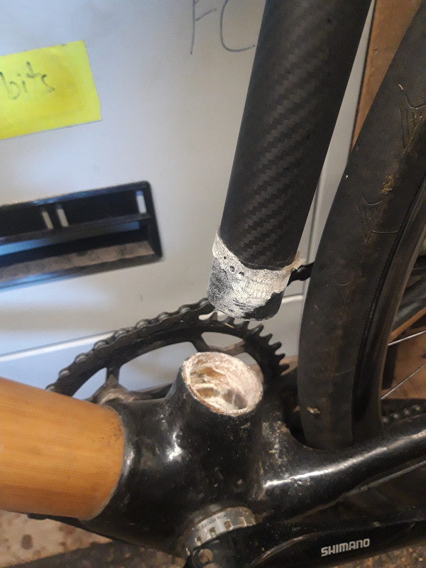

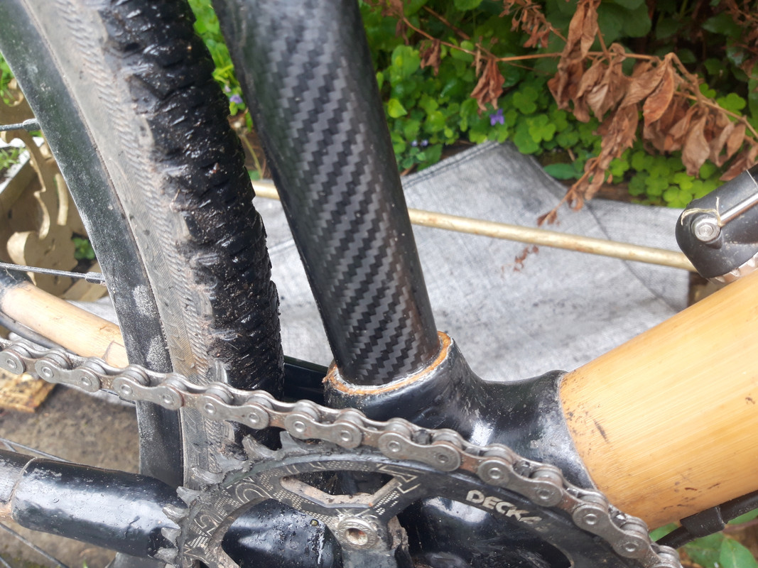

- Posts: 10437
Took reciept of the new dropper (BX 150mm Ascend), new jockey wheels, bottom headset cup for the sus forks to go on and maybe a few other things over the week. Started, as you do, with updating the cranks which were on the Santa Cruz which awaits patiently to be built.
Old m8000 175mm cranks off, new (to me) m785 XTR cranks on in 172.5mm flavour. Hopefully slightly less rock strikes and a bit more stiffness on the next episode of climb training. 130g or thereabouts saved and the xtr cranks have a 34 chainring by Snaggletooth, so I do hope it lasts as well as the original XT 32 teeth on whats come off.
Tried the chainwrap and it's definitely needing a longer chain and then went about deciding if I'd just use the standard method of, measure wrap and add 2 links. Decided to recheck the 1x method of chaineasurement and for some reason it needs 4 extra links instead of two (according to both Worldwide Cyclery and Park Tools), due to me having a 42t big sprocket up back.
Never bothered before with the 32 ring - or maybe I did and forgot I'd done so - up front but my OCD got the better of me and a bit of snapping of chain later, voilà...
Didn't actually manage to sort the dropper post nor the forks. But who cares, I've got more stiffness with an xtr crank. Not looking forward to the climbing with the bigger ring, but needs must! Up at Oxenhope/Ogden now for a loop I made during the snow by bailed...
It wasn't the seatpost. In fact a hard twist of the saddle moved the entire seat tube a couple of mm, so clearly the araldite hadn't done the trick. Further brute force proved it.
Never mind, got the whole thing out (being glad I'd gone for the thicker carbon fibre, and not installed bottle mounts yet), cleaned it up with sandpaper and IPA and tried again.
I did think about using Gorilla glue before but I didn't have any plus I've never used it before. Funny stuff.
Let it cure for a couple of hours then cleaned up the excess and left it overnight. All good but still a creaking sound this morning so I tightened the headset and that's fixed it.
