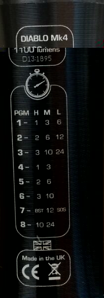

The Diablo is a good balance between power/weight/run time. The Mk4 on has adjustable settings with so you can have the option of different high/medium/low options. I got a triple piggyback battery (from Smudge at mtb batteries) with a metre long cable so I can have it helmet mounted and the battery in my jersey.

BB200 last year, I had a Maxx-D (mk 2) and a diablo (mk 5) on my head, both normally in the 10 hour mode, though they were running in 3-10-24 mode and would swap between accordingly, but generally in the 10 hour mode when riding. Maxx-D was also acting as GPS charger.
