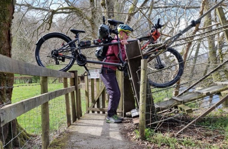

Hi all, i'm looking to do some light touring/camping with my son whose not yet 4 and just starting to ride his own bike. I've been considering all the options from cargo bikes, tandems, ex royal mail bikes and tag along trailers/bikes. He also starts school in september so some commuting to. I dont really like the width of the twin wheel tag alongs and I think i'm swaying towards a tandem as it seems less faff to store and easier to talk to each other while riding.

I currently have a Weehoo double trailer which has been fantastic. I got he double during covid and pulled my then 6 and 4 year old around. The 6 year old is now 9 and riding by himself, so i have removed the rear seat and use the area for bikepacking kit.
She is now 6, and last summer we did a great 100k overnighter on..... https://www.instagram.com/reel/CwIZP80smZt/
They are pretty good over rough terrain too, although gates can be a royal PITA!

It depends what you call off road, if it's undulating surely there's a risk of grounding out a tandem and you cant really pop the front wheel up over stuff, mind you a trailer won't like that either. Alex hit the nail on the head though, theres nothing off road around me that isn't full of gates which is a no go for either solution, so i'm thinking more sus-trans style routes.johnnystorm wrote: ↑Thu Feb 01, 2024 2:56 pmNot sure I'd find a trailer latched onto my seatpost a better option for offroad than a welded on structure!RobLyon wrote: ↑Thu Feb 01, 2024 1:22 pm Thanks for all of your replies. I think in conclusion the tandem will be better for commuting and road stuff (which will probably suit us more often) but the weehoo better off road. Is it wrong to want both?
