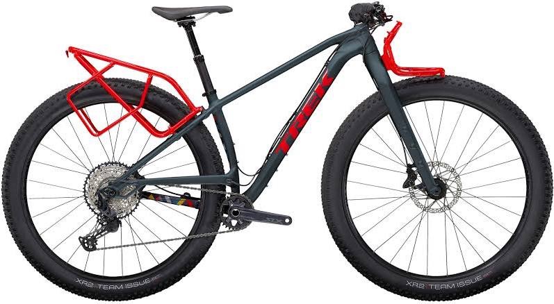

I always liked the look of this, especially the front rack holder thing as I’ve always struggled with space between the bars and front wheel
- 23524CC8-74F6-4D23-9025-5722A352163E.jpeg (119.71 KiB) Viewed 1746 times
- Posts: 9705
Re: what is a bikepacking bike?
Bizarre bit of tyre 'clearance' there unless I'm missing something!
