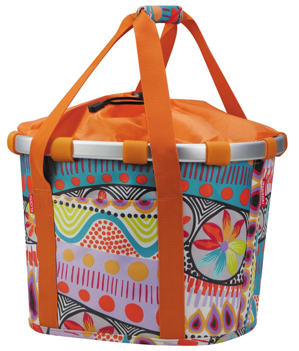

Of course Dr Nick could then also make use of R&K’s extensive range of baskets, a wicker one would look cracking on his new fat bike :wink:
Sorry nick =))

Post by Dr Nick »
If it came in black and lime green I might be tempted! :lol:
