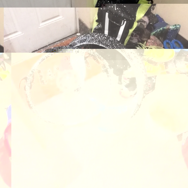

This happened while i was sat watching sweary Dave's ht550 video :o
I brought it inside after reinstalling a sloppy weather tyre in the garden.
Wasn't a good idea putting 60psi in then bringing it into the warm. It was somewhat loud.

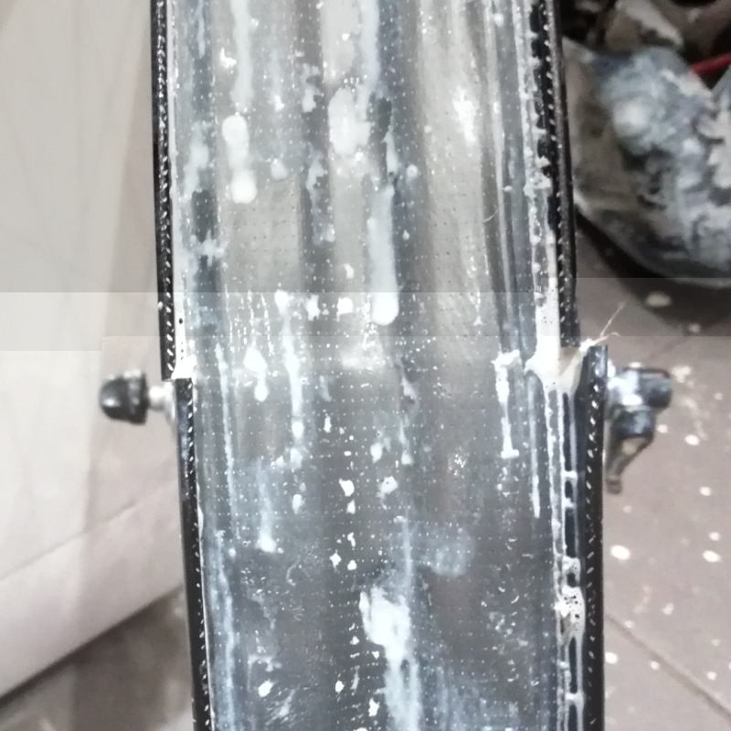

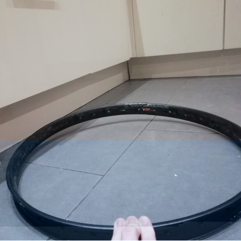

Oh ffs!!!!!
It's worse than that:
The rim is nackered :(

Just looking at the photo closeup has that failed at the weld or however the the rim is joined?
Seems odd that the rim would fail each side in a similar way.
I think I would be having a word with WTB if so.
Defo a scrapper!
It did go off like a bomb, my heart was pounding from the shock of the volume. :shock:
The rims not welded, just pinned. and the wheel is practically pringled. got a serious wobble on.
I reckon if i told WTB i'd put 60psi in it they're not going to honour any warranty.
The vast majority of rims are pinned and not welded and I think you are right about the 60 psi. Out of curiosity, what were you using for rim tape?

Odd mode of failure - I'd have expected the rim beads to split away (like what happens on rim brake rims when they are worn out), not for it to come un-pinned. Can you force the pin joint back together again?
techno
Posts: 1611
Location: Hull
Re: Oh poo, what a div!
Post by techno »
htrider wrote:Odd mode of failure - I'd have expected the rim beads to split away (like what happens on rim brake rims when they are worn out), not for it to come un-pinned. Can you force the pin joint back together again?
It's not pulled apart lengthways if you see what I mean.
Will look at the state of the rim once it's stripped down.
I'm not hopeful as it is somewhat pringled.
Edit:
No, its beyond repair.
That's an 1.5" gap.
