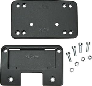

So i have a tour in the Highlands planned for next month and am hoping to go as lightweight as I dare. I already own the Carradice Super C handlebar bag (5l) with the Klickfix attachment.
I already owned the Alpkit Kanga harness system however on the Audax bike it interferes with the handlebars and cant really be mounted on the forks due to the tight clearances (due to running 28mm tyres and mudguards).
What I have done is to purchase a spare Klickfix backing plate same as below
and mount it to a piece of ply along with some thin rods at the top and bottom to allow the Kanga to be fitted.
So here it is, works really well & completed the first test ride (47m). So simple to remove from the bike & doesn't interfere with hand placement at all. Allows me to use the harness on a bike where otherwise it'd be unsuitable (due to the need to mount the bottom straps under the fork).
Overall am very pleased, draw back is there is no ideal place to mount a front light but have plenty that will mount on the straps of the dry bag.
