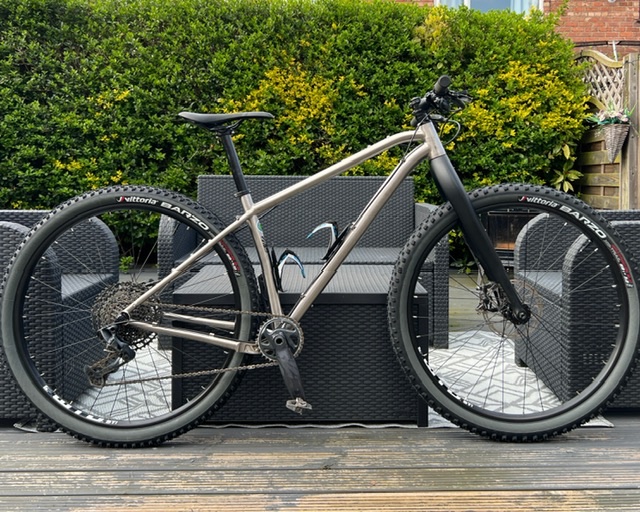

Cheers, food for thought. I’m riding a Genesis Vagabond, 2.3 up front and 2.1 at the rear. I’m only a little fella, so 10 stone, I’ve not weighed all my kit, but will do at some point. I went out for a spin today with both tyres in the 20’s, felt squishy but good. More experimentation needed, might try putting on all my kit and see how that feels.
I take in a few rooty bridleways / byways on a regular basis. They're quite good for finding the right pressure, too low and you hit the rim on the roots. So the trick is to get just enough air in that you don't hit the rim...
It is the seatpost light. Theres half a tube on the back of the plate to act as a mock seatpost. The loop is still on the light and I slotted the the new mounting plate so I can remove the light quickly by loosening the fastening 'nut' and sliding the light assembly upwards. I hope that makes sense...jameso wrote: ↑Sat Apr 01, 2023 8:38 amNeat work John - is that the seatpost mount light? Looks like it. I have one that I'd like to move to above the rear caliper brake on my road bike - currently have an Alu plate off the brake bridge that holds a round LED back-up light + reflector. It looks like you've got the steel strap/loop off the light to secure on a flat plate there?Johnallan wrote: ↑Tue Mar 21, 2023 9:05 pm The tailfin rack doesn't have a light mount and the one you can buy fits to the bag. Pretty useless with a dynamo rear light if you want to remove the bag..
I shaped a bit of ali plate and turned 4 off ali top-hat spacers. Needs better hardware and a lick of hammerite but it seems functional enough
Rode the bike down to the LBS to go tubeless - I thought about attempting it myself but I don't think my floor pump will cut it.
