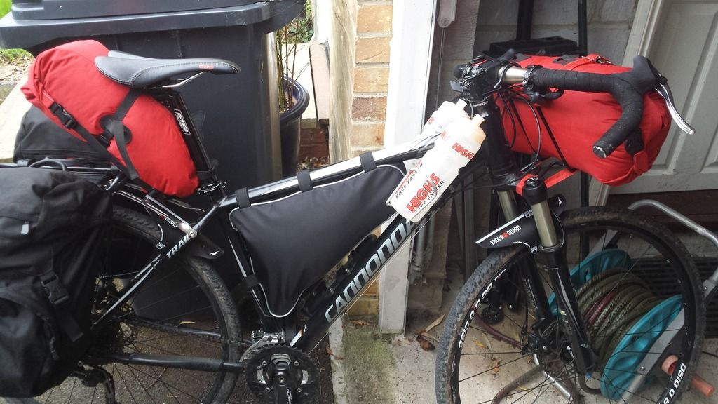

Nevis
Posts: 278
Joined: Fri Jul 08, 2011 8:48 am
Location: East Devon
Re: Offset Bottle Cage
Post by Nevis »
That looks very neat, assuming your knees don't start knocking.
Nevis
Posts: 278
Post by Nevis »
Double barrelled bottles... bit of a mash up between and the elite clips and the double mount idea.
Not problem with knocking knees if seated. I very rarely stand so that's fine but not much good it you do a lot of standing.
Got a four day ride coming up on Saturday so I'll see if they p'ed me off and I've ripped them by the end or not.
