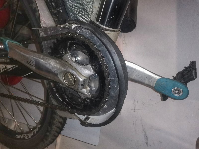

upgraded a front chain ring guard. it was a MYOG job out of catering sized pickle bucket, 5l? and some TP from some trimmed care floor mats all mounted on a ISCG 05 mount off the BB. I now has some an Allumininium backing plate riveted to it and now sits square. the original guard developed a twist after trimming it down. this is now eliminated
the guard now fends off front rear wheel crud.
to finish off in the morning..
to fine tune a rubber trim to fit...
top left Before, Top right After
Below, in the middle of the mad brain stormin session

Orange endurance sealant in front & rear tyre. as both were not hokding air. front is good. Rear seated but a leak I fear.. bike chain-guard fitted & finished... but rear tyre, faulty milkit valve,? I can't see sealant weeping..
- Posts: 7467
Liking the chain guard there, I had various goes at something similar many years ago but could never get it mounted firmly enough as the bike didn't have the ISCG mounts.

we here is it finished. it now parallel to the chainsetfatbikephil wrote: ↑Fri Oct 22, 2021 1:13 pm Liking the chain guard there, I had various goes at something similar many years ago but could never get it mounted firmly enough as the bike didn't have the ISCG mounts.
Anyway, I've just spent a long time washing / scraping / chipping sheep sh*t of the Jones and generally pampering it after performing so well on the BB200. Hopefully said dung will assist with the growing of my new bit of lawn![]()
that the most important part. the old one skewed when trimming it to fit. a bit more 'research reveled it is an ISCG03 (not ISCG05, different screw positions)
