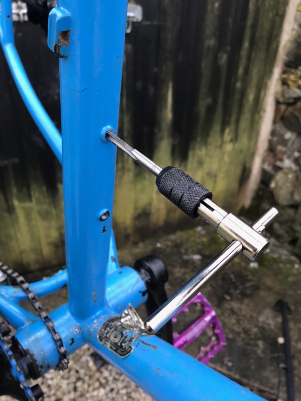

fatbikephil wrote: Fri Mar 22, 2024 11:36 pm That said stainless bottle cage bolts corrosion welded into ally frames can be much harder as there is less to hack away at!
And there's your occasional reminder to go loosen and retighten all the bolts! Far easier alloy bolts and steel frame but still …

Hyppy wrote: Sat Mar 23, 2024 11:25 am
Nice1 Hyppy. Nice tap work you got going there. What cutting oil you using :grin:
Posts: 532
Re: Off Topic - siezed, rusted, possibly double threaded, sheared bolt extraction advice!
redefined_cycles wrote: Sat Mar 23, 2024 11:44 am
Err … likely a no-no to you proper mechanics but as a one off job (and being only a bottle boss isn't mission-critical) I didn't think it worth buying anything special so just a blast of GT85! 😞
