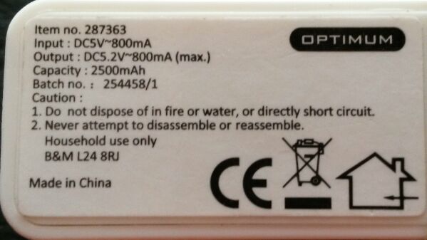

Was in the local B&M Bargain store too, on charge now, will report back. They've probably got a single 18650 cell in them, but if it'll hold a good charge, a fiver is a great price.
Posts: 4128
Re: Cheap(er) dynamo to USB power option
What capacity is the B&M battery and will it give out charge while recieving power from a dynamo?
Cheers
Posts: 4022
johnnystorm wrote:Battery packs back in at B&M. Will do simultaneous charge/discharge.
From earlier in the thread! ; )
I'll check on capacity in a bit.
Posts: 4022
Here you go:
Enough for a full, albeit slow, standalone charge of a typical smartphone. It's ok for a buffer charge as you go but takes it's time if what you want to do is charge a flat device.
Posts: 5449
Just bought a B+M cell to go with my (different/german) B+M USB-Werk charger, one with a small cache built in to keep GPS from signalling 'lost charge' (£55 from Rose Bikes clinched it). Gave up on my home-made one for now .. got the battery packs charging with a charge level indicator but the switch to discharge to a device needed a few parts alongside the regulator and I realised it wasn't going to package well or be reliable, yet.
The USB-Werk puts out 500mah. This battery puts out 800mah. So If I charge up the battery at home then plug it into the USB-Werk and the GPS as I ride, I guess I'll get a faster charge to the GPS but a gradual drain on the cell? Just thinking of using the cell as a 'sht need topping up!' back up.
800mah, that's halfway between the charge speed of a PC USB and a wall-mount Garmin charger I think. So it'll speed it up a bit, but not dramatically.
