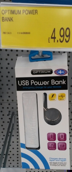

Battery packs back in at B&M. Will do simultaneous charge/discharge.
