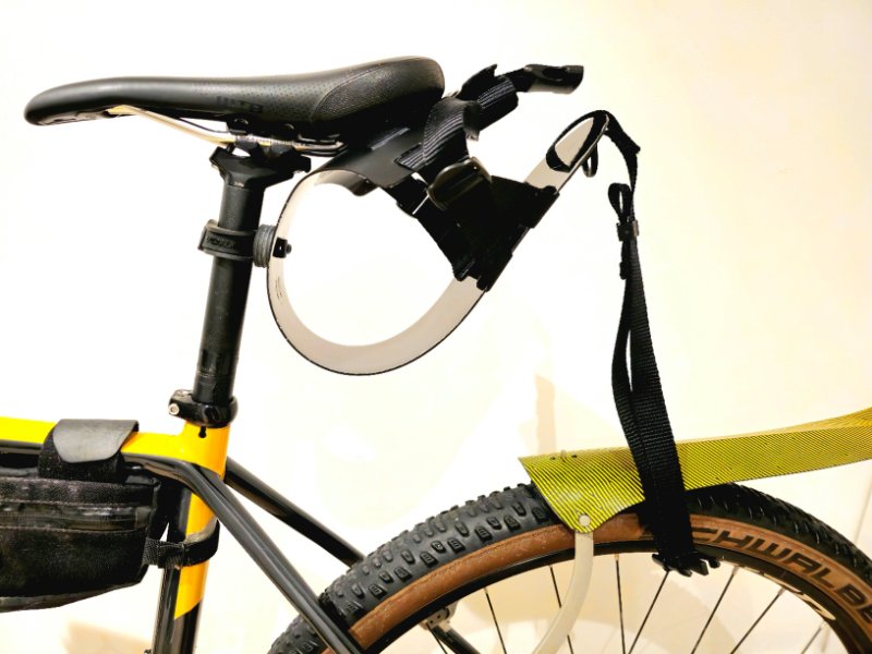

However! After my branded harness failed during BB200 I thought it would be fun to produce a saddlebag harness myself, and save myself some money in the process.
Now that I've done it, I can say it was sort-of-fun but it definitely has saved me NO money and in fact I had to make 6 harnesses which I'm now selling hoping to get back some of the money I had go spend to order material in small quantities (opposed to industry-sized batches).
The harness heavily inspired by an existing product and is made of plastic and CNC cut. The straps are sewed and allow to install the harness on pretty much any bike using the saddle rails and seat-tube.
If you have a dropper-post, the harness should allow you to still use the dropper although you might need to limit the travel of the dropper.
I've tested my harness on the rocky trails of the Peak District, on a rigid bike, and I can't notice any tail-wagging.
Ideally you won't load it up with more than 2kg / 8-10l volume, but I haven't tested mine up to the point of failure.
Tbh I think I would be OK with larger volumes, but might start shaking a bit.
If you care about weight savings, this harness saves you about 300gr over traditional saddlebag solutions.
Think about how much you'd spend on lighter pedals/cassette/wheels to save that much weight.
I'm selling the basic version for £52 (2 left) and the upgraded version either a fidlock magnetic buckle for £59 ( 1left).

Valerio wrote: Mon Jan 22, 2024 4:23 pm If you care about weight savings, this harness saves you about 300gr over traditional saddlebag solutions.
I've scanned your text twice and I can't see an actual weight for what you have created?
My Wildcat harnesses and basic Alpkit drybags save over 300g over a "traditional saddlebag" ie my no-longer-used ye olde Carradice Barley.
What I'm interested in is what weight saving this is over a Wildcat-style holster?

Dyffers wrote: Mon Jan 22, 2024 4:46 pm
Not naysaying though, great work. :-bd
Thank you!
Apologies I'm struggling to post multiple images here but if you're interested send me a private message with your email address and I'd be happy to send you a few photos (including the harness over a scale).
If you use Instagram, there's a link on my original post to a few shots and details of the harness.
The harness weights roughly 175gr (no dry bag), so very similar to the Wildcat Tiger Drover (185gr) harness, assuming that's the one you have.
My Restrap harness (14l version, no dry bag) is just shy of 500gr which I believe is more or less in line with the average weight for this sort of harnesses and that's what I compared it against. Mainly because it's the only other harness i could check it against using the same scale!
An advantage of this harness is that it takes little space on the seatpost and should allow most droppers to work, to a certain extent.

Posts: 2619
Re: Ultralightweight saddlebag harness - dropper post compatible
TBH I was hoping to come up with a design that worked well enough that I would be able to make a few to sell and at least make something for my efforts/but materials in sensible quantities. I thought the plastic sheet design would help that, in that once you've done the design, there's next to zero effort in getting it cut - compared to a sewn fabric design. But I hadn't actually looked into the cost of manufacturing at scale, so I could be way off.
Fair play for at least getting as far as making something that works - I hope you are least got some satisfaction from that.
What material and thickness did you use if you don't mind me asking?

Valerio
Posts: 87
Post by Valerio »
The profiles are cut from a 1.5mm Polypropylene sheet.
I was hoping to be able to order a A3 sized sheet to cut a profile, but that is considered too small of an order and suppliers (well, the ones I managed to find) apply a hefty surcharge on top of the price.
Hence why I had to order way more than I needed and ended up making 6 harnesses rather than just 1.

Posts: 2619
Cheers. Tried to check what I used but can't find the invoice - definitely PP, think it's also 1.5mm, possibly 1.
