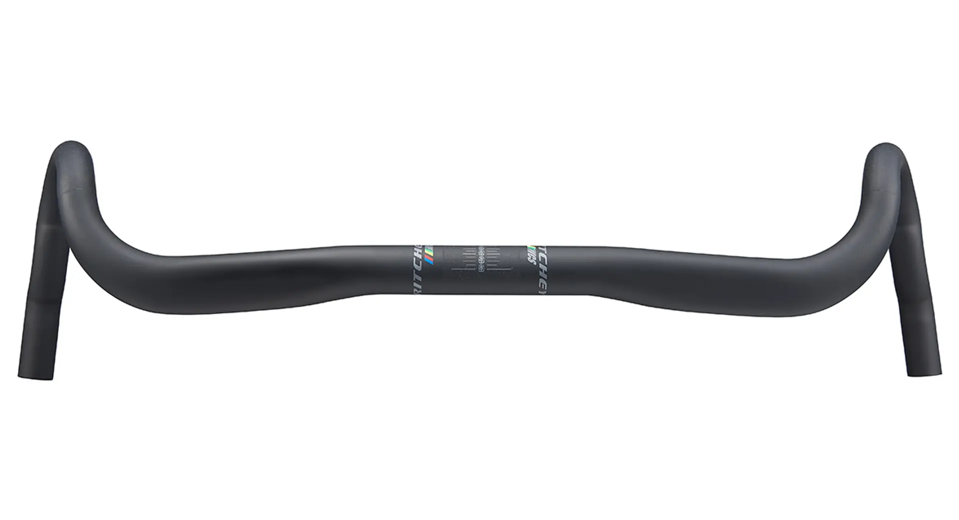

Re: Gravel riders - Sore palms advice sought
Ritchey VentureMax bars have the "shelf" built into them and the dimple in the drops is remarkably comfortable too, IME. Although the Redshift mean you don't have to buy new bars
https://ritcheylogic.com/bike/handlebar ... -handlebar
NB: these (above) are the XL as they are what I use being a bit of an ape. For the price of the Redshift you can get the slightly less broad VentureMax for the same price (Google may even find it cheaper):
NB, NB: having just browsed more they do a "Comp" version of the VentureMax XL (same/similar 56 cm width) that is similarly priced (c.£50) as well. So many choices
