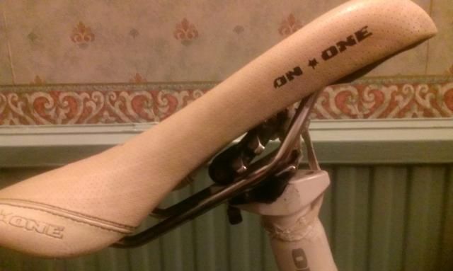

Set off on a BB200 practice bivy on Wednesday, plan was to ride from home (Wirral) head out towards the Clwyds and find a nice spot near Moel Famau. At literally the furthest point from the house I got to the top of a hill, there was a loud “SNAP” and my saddle fell off ! :sad:
Not sure if had anything to do with the weight of gear in my saddle bag (nothing out of the norm) or whether the continuous riding with weight hanging off my saddle had caused the bolts to weaken?

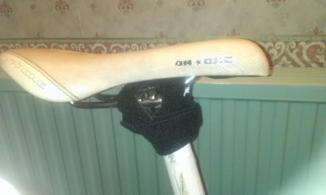

I managed a quick fix with some Velcro and attached my saddle bag to my bars but after ½ hour had to admit defeat and ring Mrs Barney for a pick up.

Just unlucky I reckon Mark. I take it just the bolt snapped, not the actual post?

That's the good thing about that kind of seat post. The weak spot is the bolt.
Two spare bolts for longer trips is all it needs.
It's also a sensible place to check the right torque.
I use Thomson posts on my bikes (except for one that's got a reverb). Expensive but light and reliable.

Yeah, thomson posts are worth the extra, internally ovalised tube wall, stronger for the loaded direction, lighter where possible.
